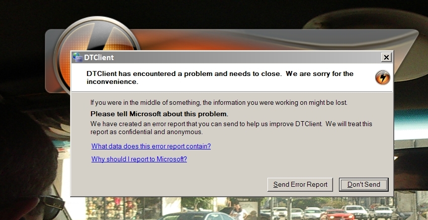

          I have the same problem. Also using windows XP. I have no idea what Eset Nod32 is. The problem occurs on program start. I have uninstalled and re-installed. The problem persists. What to do ? Screen shot below -
Name:	DT Client.jpg
          Stephen James.
            [ATTACH=CONFIG]1528[/ATTACH]
            Stephen James.
