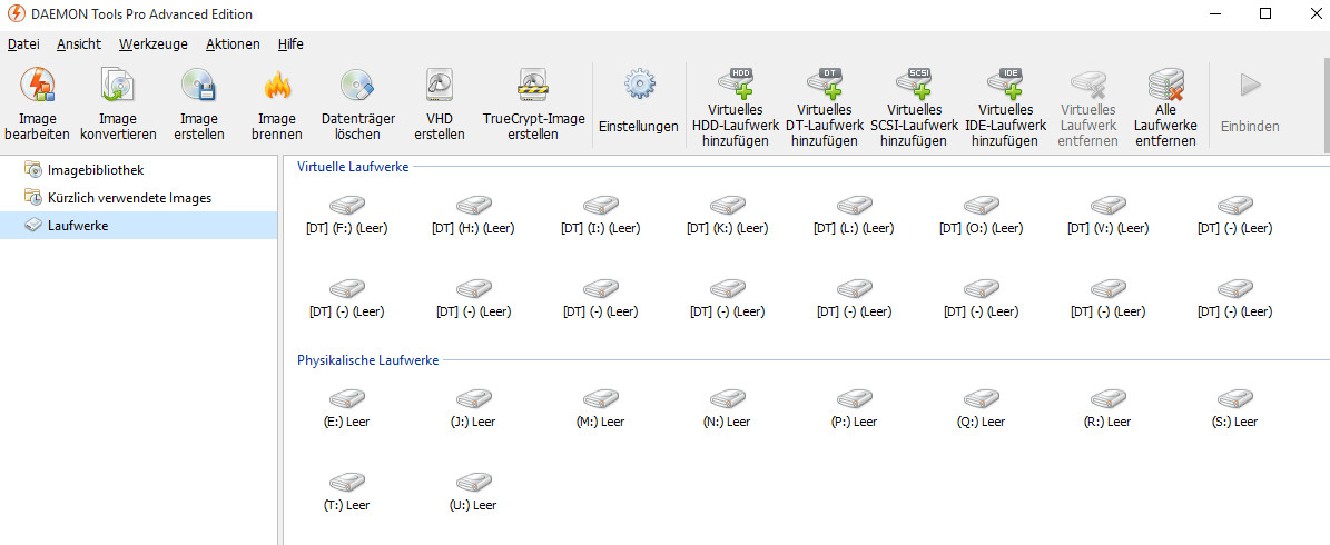

                I have the same Problem on Windows 10 Pro and I had the problem even under Windows 8.1 for about half a year.
                Again and again I when reboot my pc, I have a new virtual drive in the list. I always has to remove them manually.
                For one period of time I get even new physical drives I do not have.
                Thanks for your support.
Name:	2015-09-18_DAEMON Tools Pro.jpg

                  I've the same issue here on Win 8.1 x64 and Win10 x64
