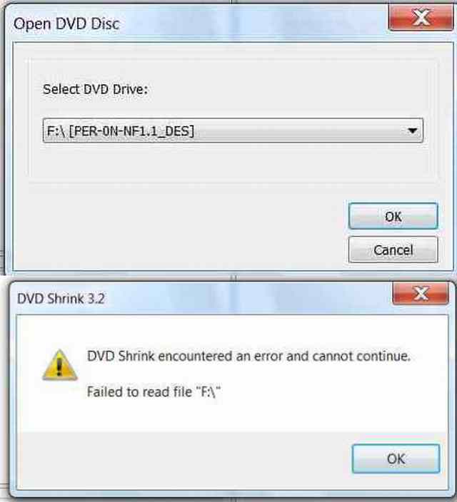

        Upon more sleuthing I found that the problem might lie with dvd shrink. Shrink correctly recognizes the virtual drive, (F & my dvd drive (D. When I select the virtual drive, F:, which contains a 6.48Gb ISO file, it displays it as a choice but when I select it & click "OK" I get the error msg shown here:

          Now that I see the attachment & how small it appears I wish I had made it larger. However, if u click on it it is readable.

            DVD Shrink is pretty strict about a correct DVD structure.
            Which program have you used to create your ISO and remove the protection of The Sands of time ?
              Re: confusion
              I used AnyDVD to decrypt & create the image file on the HD which I then mounted in the virtual drive. However, I know that when I use shrink on a dvd in the physical drive the disk does not contain an image but multiple VOB files etc. I have been under the impression that it made no difference to dvd shrink. There doesn't seem to be a way in Daemon tools to mount the file the same way it appears on a disk, as multiple vob files etc. BTW: I use dvd decrypter to make an image file from the virtual drive onto the HD just to check if it would work & it went fine. I guess the same applies to dvd shrink.

                DVD Decrypter doesn't care about a non-standard/defective structure, whereas DVD Shrink does very strictly.
                Mount your ISO and try to remove the remaining scructural problems with either RipIt4Me+DVD Decrypter
                or DVDFab Passkey+ImgBurn
                Or try to make a completely new Rip of your DVD with DVDFab HD Decrypter or DVDFab Passkey+ImgBurn.

                  Sorry for taking such a long time; it took me a while to try your suggestions. I mounted the dvd & used ripit4me & it worked. I also discovered that when I mount an iso file in the virtual drive it appears as a movie file with the vob files etc not as movie.iso. Just part of my learning process. Copying my digital home video movies is another important use of this prog for me. Last year I converted them to iso files to have some kind of organized storage; some of the files were 8 or 9 Gb, too large to copy to dvds. I only realized this recently, so DT comes in very handy for that too.
