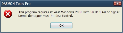

    After having to reinstall windows I now get the SPTD error and I have no idea how to fix it since I can't reinstall that version due to the installer being locked so I was wondering if there's a way to fix it by some other means. Any help would be much appreciated.
    Please post exact error message or attach a screenshot.
      Here's a screenshot

        Reinstall SPTD and/or check your security soft.
